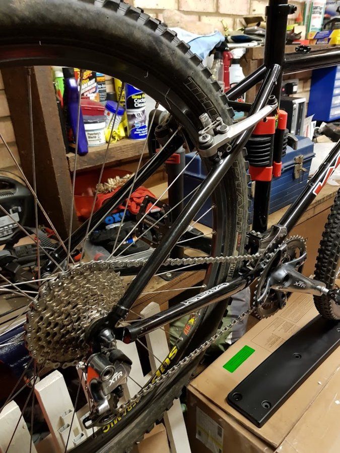

Bit of an update for you as some bits have started arriving ^_^ First to show up was the headset, an FSA Orbit XL II. That arrived last week as mentioned above. The XTR bottom bracket arrived this morning, as did the frame (yay!), some bars and the XTR chainset and mechs that I sourced through eBay. I've excitedly assembled what I could so the bottom bracket is fitted, the headset cups are pressed in to the headtube, the chainset is bolted on and the rear mech is fitted. I've now got to play a waiting game until more bits start to arrive :laugh:
I managed to get hold of some XTR brake levers and a set of wheels from eBay over the christmas break. The wheels were a bit more than I wanted to pay but seem in good condition and came with tires and a cassette which I would have had to buy seperately - £150 for XTR hubs and Mavic X517 ceramic rims isn't too bad, just hope they're relatively straight :laugh:

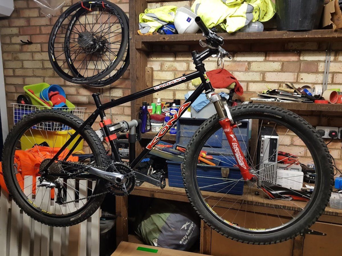

Anyway, here is a pic of my current progress:
And here are the other bits that have arrived and are awaiting assembly:
I already love it :blush::wub::blush: Really looking forward to getting my hands on the forks and fitting them up but the stem seems to be about a week away - I might have to attach them with cable ties when they arrive just so I can gaze at it longingly in the garage :laugh::tongue:

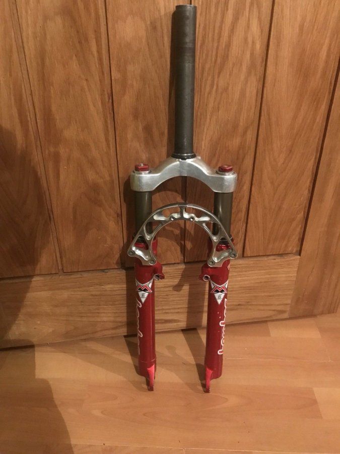

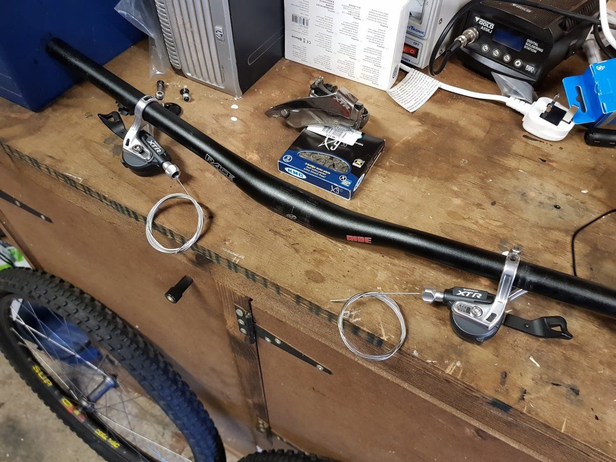

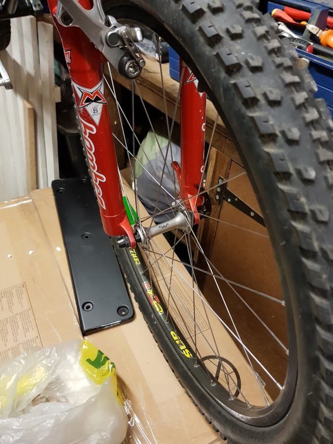

The bombers arrived this morning, as did the wheels and shifters. Mixed results on this round of eBay "bargains" :laugh:
I'll start with the positives... The forks look awesome and seem to function ok - they make the same squelching noise I remember my old Z1's making and all the adjusters move freely so all seems good. The colour is almost exactly the same as the Kona graphics - they look like they were made for each other :smooch:
The shifters also look amazing, hardly a mark on them :becool: Whilst messing around with them I realised I've accidentally bought a rapid rise rear mech so the shifting will be backwards to what I'm used to on the Stumpjumper and previous bikes. That now makes 5 bikes with 4 different shifting methods :laugh: Confusing much?!

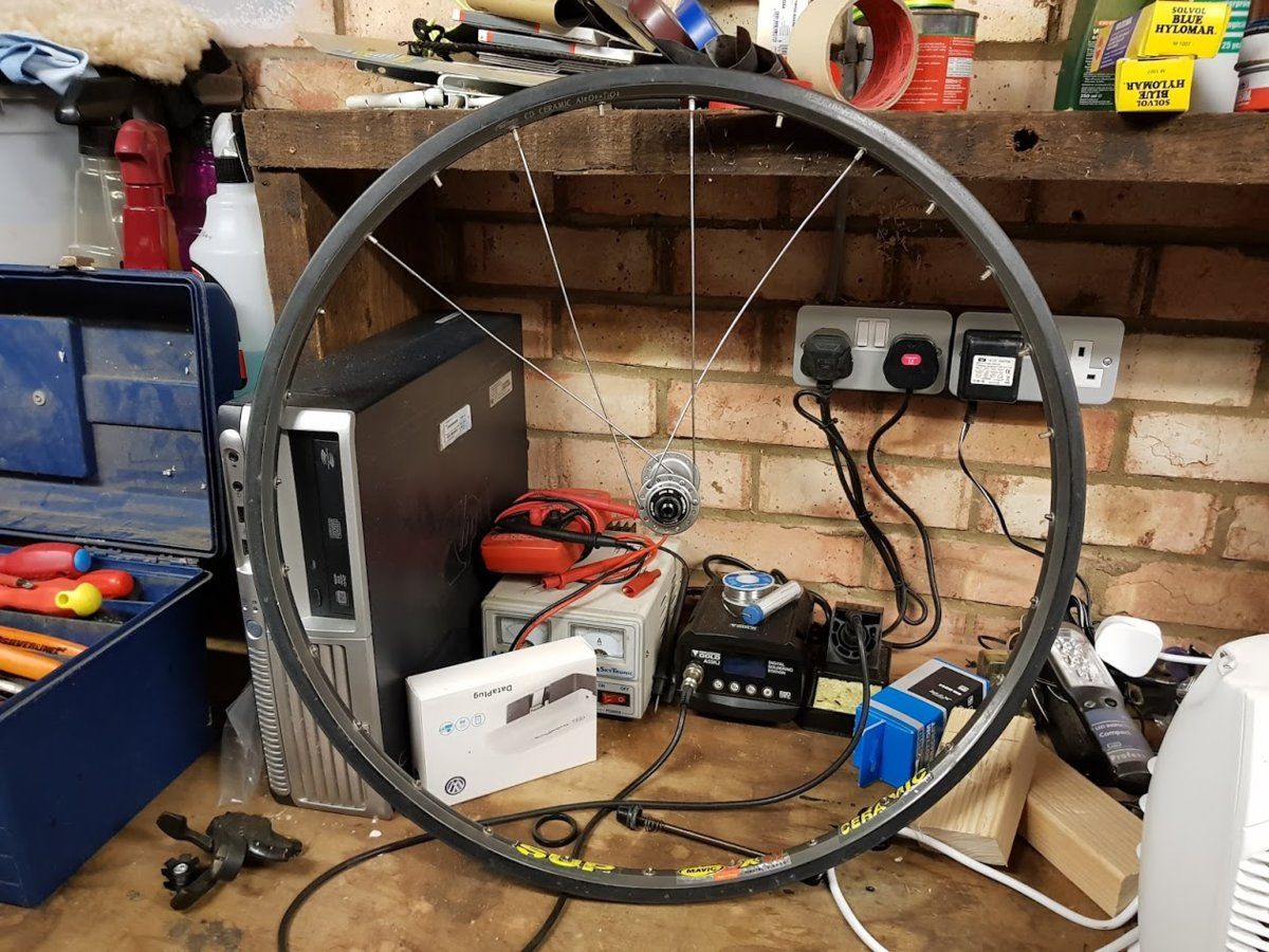

On the downside the wheels were in much worse shape than I had anticipated. The front XTR hub is basically scrap - missing lock nut and bearing seals, bearings shot (cups, cones and balls) on both sides, brown rusty water came out when I whipped the axle out to see why it wasn't turning which is never a good sign :rolleyes: They were advertised as good working order so hopefully the seller is reasonable about it - I have requested a partial refund to cover the cost of a new hub and will rebuild the wheel myself if they accept the proposition :okay: Otherwise I'll be sending them both back for a full refund and will start looking again :sad:
I can't get over how good the bombers look on that frame :laugh:

I've now got a new old stock XTR hub on the way from Poland :wacko: It was the only 28 hole one I could find of the right age, I guess even well looked after examples are getting pretty tired after 20 years of use! The eBay seller was very reasonable and agreed to the partial refund so I'll only be a few quid out of pocket with a bit of luck. It does mean I've got to remember how to build a wheel though... :laugh:

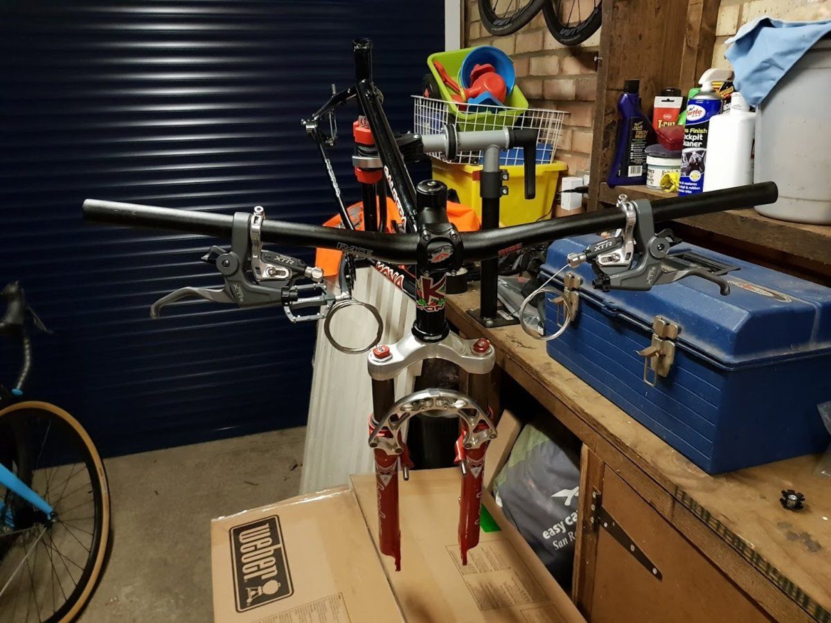

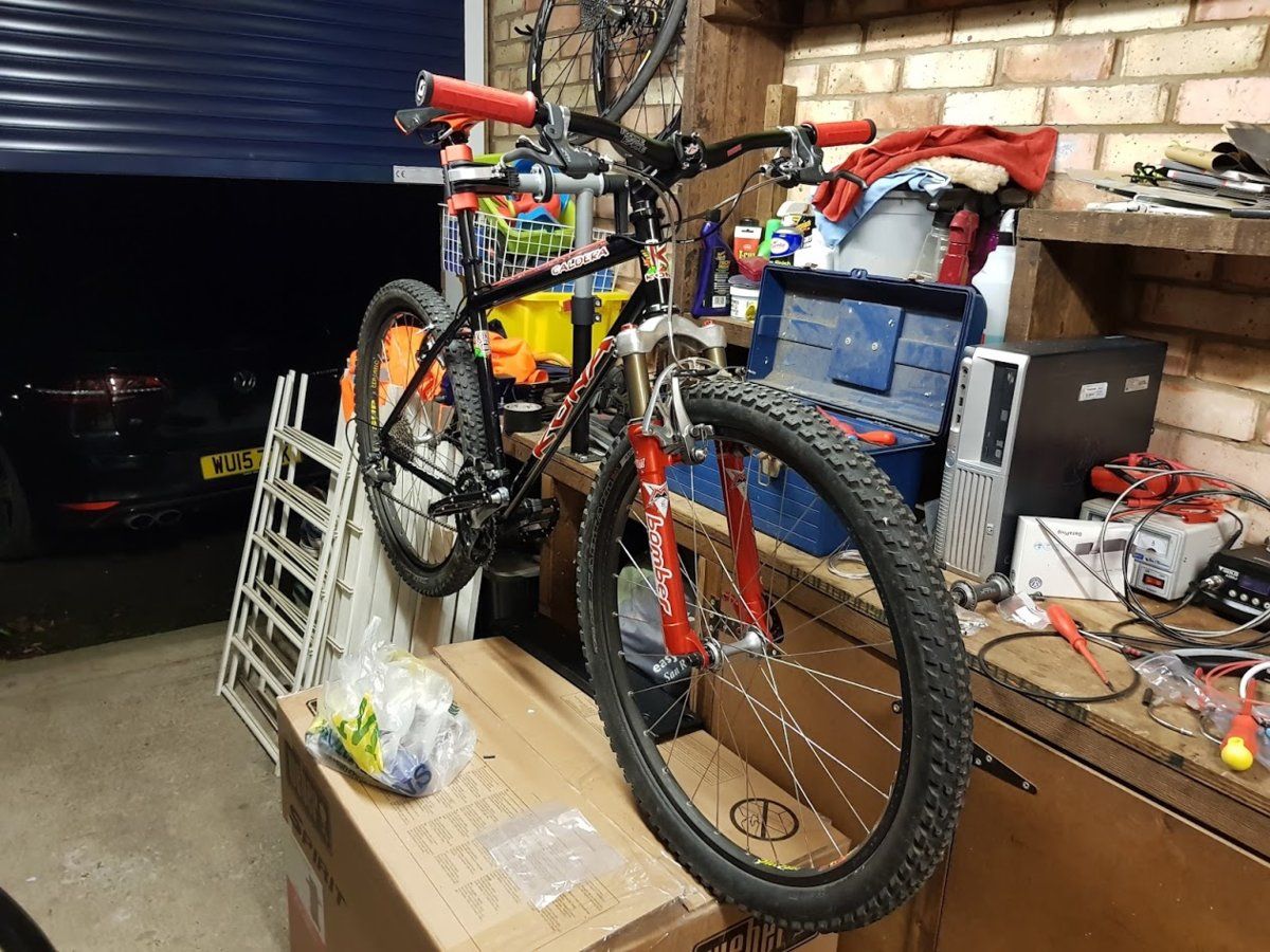

I had a nice little surprise in the post today too - my stem, headset spacers and bomber brake bosses arrived so I've fitted a few more bits this morning ^_^
Not much more to do now until more bits arrive next week. I think the only bits I haven't ordered are brake cables and gear cable outers but I'm sure there'll be something I haven't thought of :laugh:

Brake levers arrived this morning so have been popped on to the bars :becool: Still awaiting the v-brakes themselves and several other bits but I had notifications today to tell me the saddle, seatpost and new front hub have been dispatched ^_^ Hopefully by the end of the month I'll have it all together :becool:

I put a few more bits and bobs together this afternoon. The front wheel is only loosely fitted at the moment - one of the axle locknuts are missing so if I were to clamp it up it would bend the fork legs in which I don't really want to do..! It'll come off again for a rebuild when the replacement hub arrives ^_^ There's a decent sized wobble in the rear wheel too so that'll need some attention before it gets ridden in anger :laugh:
Having the wheels on meant i could stand it on it's feet for the first time and free up the work stand until more bits arrive - It does look a bit teeny tiny next to the Stumpjumper :laugh:

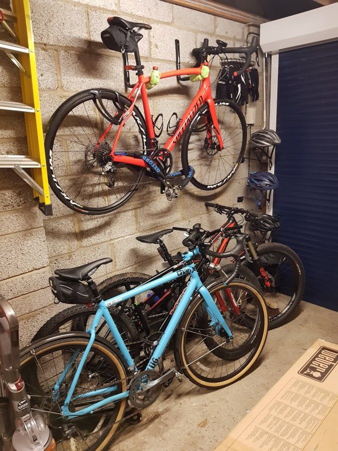

I had to shift a few bits around in the garage to make space for the commuter but it all fits in nicely again now with a decent walkway through the middle. The Aria is going on hooks on the opposite wall when it arrives so I shouldn't have to do much more shuffling for the time being ^_^

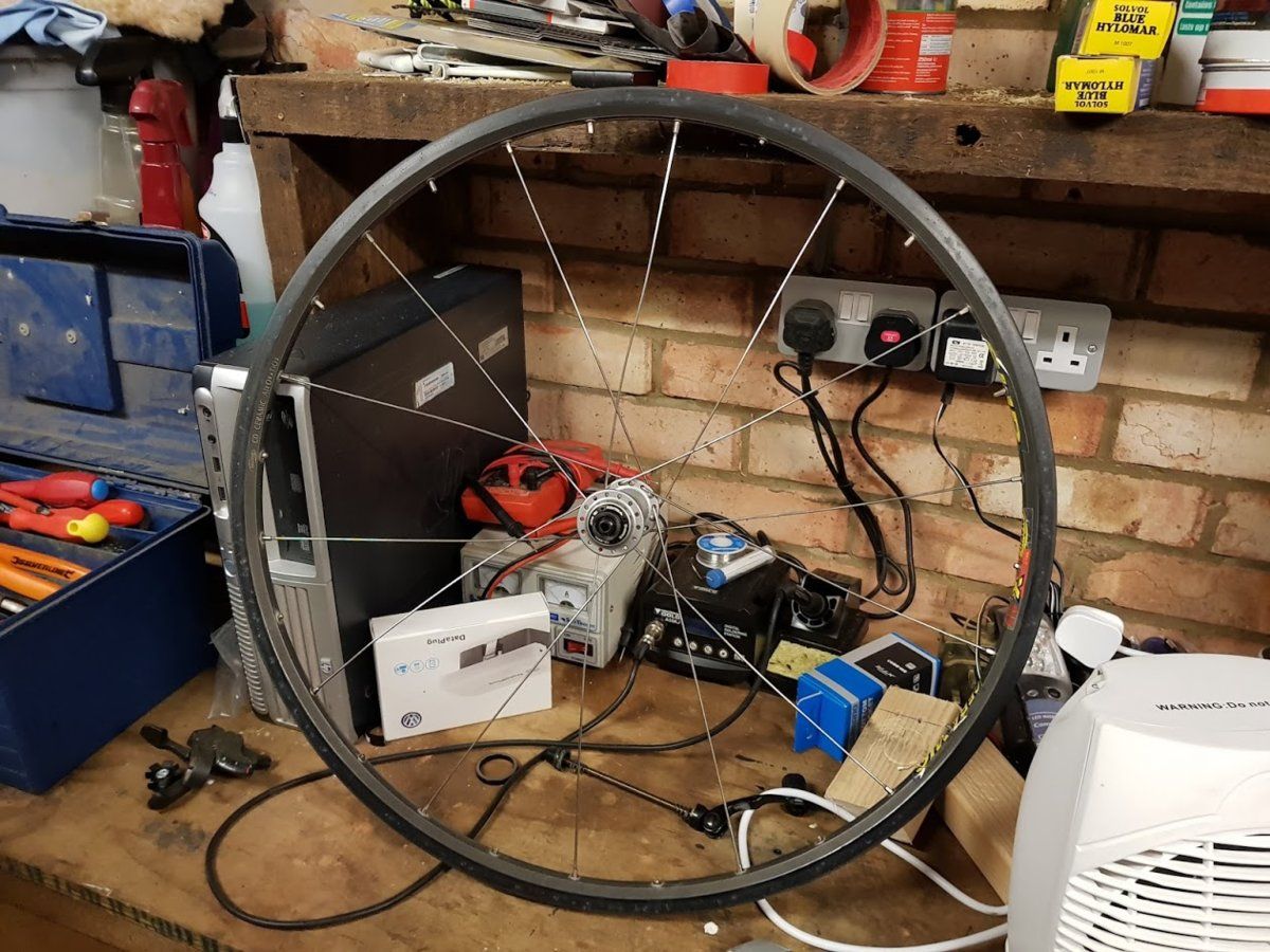

The hub arrived this morning and I couldn't wait to see what it looked like built up... Lets just say I won't be needing a new spoke key or truing stand anymore :laugh:
I was pretty fortunate in that all of the spokes were in good nick and none of the nipples had corroded or seized so I stripped the wheel down in about 10 minutes. I made sure I laced the new hub up with the same pattern so the spoke lengths would still be right then gradually went round and tightened them until they all had a decent amount of tension. A few small tweaks and it's running pretty straight - I'll go round it again once it's settled and take the last little wobble out but I'm really pleased with it since it only took about 45 minutes and is the first wheel I've built in about 15 years :laugh:
With the new wheel on and tight it meant I could take it for it's first spin - a whole 30 metres around the cul-de-sac :laugh: Lots of twanging from the front wheel at first as you'd expect but seems to have settled. More importantly the bike feels great - I couldn't have asked for a better riding position :becool: It feels longer and leaner than the stumpjumper and the short travel fork feels great. I might give them a quick service at some point but I'm not sure they need it - they were certainly 50 quid well spent ^_^

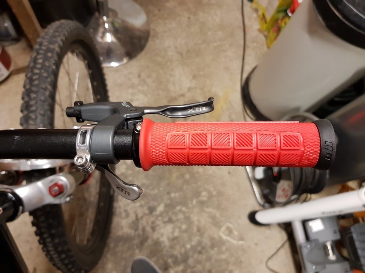

New grips arrived - installed in a jiffy and cockpit controls adjusted to comfortable positions.
The new brake and gear cables also arrived, they took a bit more fettling but the brakes are centred and biting well and the gears are all indexing properly now ^_^
The finished bike - a slightly upgraded version of my second 'proper' mountain bike but very similar indeed. I could have bought something superior by todays standards for less money but that's not what I set out to do - all thats left to do now is get out and ride the thing :laugh:
