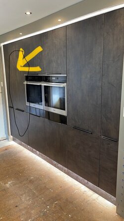

Think I may have stumbled upon an installer problem with our new kitchen. Our built in Neff fridge is warm, not cooling great. I need to cut a vent in my plinth. Also need to cut slots in my carcass as well. It’s floor to ceiling units ! It’s a guess but it fits the problems I have over heating !!

Yes I just replaced an inbuilt fridge freezer unit. They should have space underneath. Mine was stood on a U shaped base, so the hot air from the motor could go into the void to dissipate . I had to raise it to make the new unit fit the doors, so used an offcut piece of worktop, but I cut out a similar piece to keep the ventilation to the void.
as @fossyant say, get the installer back. You may just want to undo the door clips and slide it out to prove your theory first though.

I may get in contact but it would be easier for me to fix . I’ll get the door off when I get in and take it out and have a look in the carcass. Should be an easy fix . Might need to just cut some slots and holes to allow some air in.

I would read the installation instructions and see what the specs are for vents - even if the fridge isn't warm, it will be inefficient without proper venting, and costing you money.

The base should be cut something like this - support for the legs / unit but a void for ventilation.

If memory serves me right the fridge ( Neff) has s sealed along the sides and back , which means it must be open on the bottom only ! Jigsaw or circular saw should do the trick. Might stick a vent on the plinth as well , shall see .
presta
You need two vents to create a rising flow of air over the condenser on the back of the fridge, one at the top for hot air to escape, and another at the bottom to let cool air in. One vent at the bottom is no use, because the hot air will still be trapped in the cupboard like the air in a hot air balloon.

yes do that - Who designed this kitchen and didn't put a vent in the plinth?
Mine has vent in plinth below fridge freezer int the void area, and the unit the fridge/ freezer sits in has no back and short top so is effectively vented at the top wall side.
