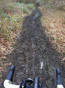

Just reading this, l’ve had Marathons on my work/do-it-all bike for over 3 years
(Durano DD before that)
They’re better rolling than l thought they’d be
Plus they cope admirably with muddy conditions!
This is about their limit though!

I think they’re the ‘Plus’
That said, l have ridden in that much mud on Duranos, but had issues on the little off-camber climb at the other end of that route home
