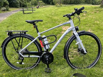

Loving my new Ridgeback Element EQ, great bike, but the lights are flashing all day. Can’t see a switch anywhere to put them off during daylight. Is this just the way they are?

From the photo, it looks like the rear of the headlight body may rotate as the switch. Check if it has more than two positions, as it may have off/on/daylight sensing. (That’s how my B&M lights work from my Shimano hub dynamo. Although mine don’t have a flash mode.)

Did you check if that bezel at the rear of the light is the switch?

As other's have said, there's a rotary switch on the back of the front light. Don't worry, if the LBS I'd bought my similarly equipped Trek District from hadn't have pointed it out, I would have probably made the exact same mistake and missed it.
The front light will probably come on constant when you go a bit faster.
