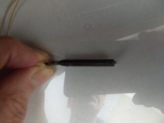

The is the key :
Viewed from the underside, it doesn't show any sign of a piece having broken off – all the lugs are the same dark colour.
I'm hesitant to use too much force for fear of breaking it off inside the lock.

The deepest cut on that key looks worn.
Yes, that was my initial diagnosis.
