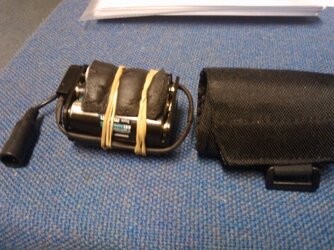

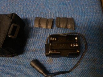

For anyone interested, this is my modified pack I use for my rear magicshines.
Takes 6 x AA's, fits inside the original pack casing, and costs about £3 to make (excluding batteries).
Could be a handy 'spares pack'. The foam is used to retain the middle battery with a couple of elastic bands.
Edited to include the pack loaded up !
