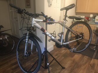

Recycled 90s GT Aggressor 3 Mech Disk brake - front on applying full force at the brake lever - one very loud Click/Clunk at the end of the pull = no brakes (Scary) - a recurring theme unless I get the local bike shop to fix
Tried new cable new pads - I know it’s me as I’m a hopeless amateur mechanic 😉 but it’s infuriating to be so useless 🤣🤣🤣 -anyone pls put me out of my misery and explain what I’m doing wrong / fix

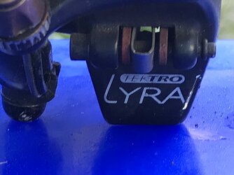

Sounds more like the brake caliper is passing the end of the cam (or whatever mechanism it has) before sufficient clamping force is being generated?
Any clues as to what make/model of caliper it is?

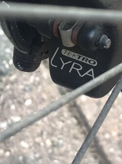

Here’s the front image - your description of what’s happening sounds spot on ? Can I repair it DIY or is it a new part or a cycle shop repair
Once again thanks

Remove cable and screw in the adjustable pad until the disc is almost held solid. Now pull the actuation arm by hand and see if it is tight or moves easily. This establishes if the caliper is functional. If the caliper checks out then it is just your set up that is at fault.

Fwiw I had Tektro Lyras on my Boardman CX - they are crap by any measure, setup & pads made very little difference. Swapped them for a set of Avid BB7s (about £30 s/h off Ebay) and the difference is night & day.
