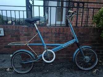

Picked this up tonight. I've sort of wanted one for ages, but every one I've seen on eBay seems to have been way overpriced. This one was £80, is rideable and was a ten minute walk from my house. Result!

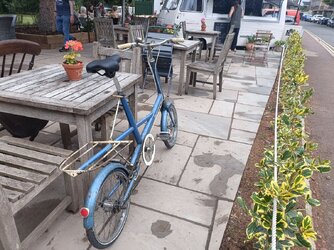

My boss Matt is a keen cyclist himself, but he really doesn't get my penchant for odd bikes. This is his response to the Moulton... 😂

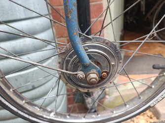

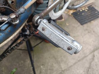

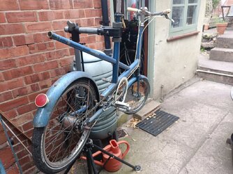

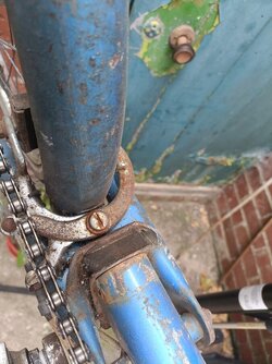

Just having a very quick look at it this morning, as it was almost dark when I got it home last night (and I was four beers into my Friday evening). I'm no expert on these, by any stretch, but I think it's a Mk 1. The hub is a four speed and is dated December 1964, and the pedals are pretty worn but I think might be the original items. The brake calipers will be swapped for Weinmann items: original or not, I can't live with those horrible pressed steel things! The rear fork - a weak point on Mk 1 bikes, from what I've read - seems to be ok. There's a bit of play in the headset, but that's easily rebuilt.
I was toying with putting drop bars on this and maybe building wheels to take a cassette and fit it with a derailleur, but the more I look at it the more I think I'll just fettle it a bit and keep it reasonably original. Anyone know where I can get the pedals re-treaded?

Yes, that's a series 1. The rear fork WILL eventually crack if you ride it and aren't sylph-like (men were on average about 2 stones lighter when this was built).
Is it a Bradford-on-Avon or Kirkby-built bike? The Kirkby ones have a K in front of the serial number or the year on the seat tube, and were built in a Merseyside washing machine factory. They are often quite poorly put together.

It's a Kirkby bike. K65 is stamped on one side of the seat tube, which indicates a 1965 build. Which ties in with the date on the rear hub. I am a big heavy lad at over 100kg, so I'm wary of riding the thing any distance! But if I do decide to restore this, I think getting the rear fork strengthened will be a priority.
