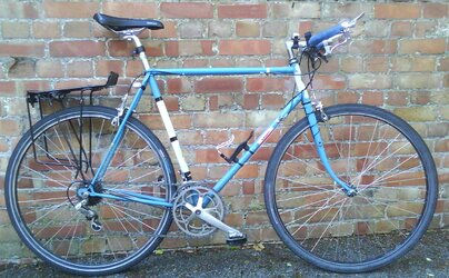

I've just been out again with the seat higher, this combined with the seat forward really makes it feel better except for stopping and starting at junctions so I need to try a zero-layback seat post; maybe one with back-forward adjustment independent of the clamp to the saddle rails?
Can anyone recommend one please?

Here's what I've found:
SDG I-Beam Micro BMX Seat Post
http://www.wiggle.co...-bmx-seat-post/
plus a Post Moderne Seat Post Shim:
http://www.wiggle.co...seat-post-shim/
total; just under £30
Comments/other suggestions welcome.
thanks

I had a nose and 27mm posts seem to be in short supply, but plenty of 26.8 and I assume you could use a shim.
Thanks MacB and everyone who is helping me.
I'm advised by my friend Adam, who gave me the frame and the seatpost, that I must use a 26.6 post. 26.8 will not work. I'm looking for a 25 or 25.4 (or anything less than 26.6) and a shim.
The 25.4's seem to be BMX posts and too short. I'll visit Evans today to get the length of the Odyssey Intac Micro Adjust Post

Problem solved; I got a 2 part seat post (old fashioned type) from a local shop, my position feels much better.
Thanks to all.
