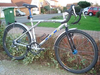

My own touring takes in as much off road and bridleway riding as possible. I used to use mtb's but have for the past few years been using a hybrid. There is still a fair bit of road and reletivly solid and flat tracks riding involved so the hybrid's larger wheels have become much apreciated. While it has worked very well I am now considering trying one of my old mtb's and fitting 700c wheels. Partly because my mtb bits are of far better quality than my hybrid but also because I think it will do a better job off road. The technical difficulties like lack of brake position and pannier mounts (any others?) can easily be overcome but I wondered if anyone here has already used similar and what their opinion might be.

I had 700c wheels on a standard 26" wheels MTB for ages then upgraded to a 29er.
700c wheels fitted with 23mm tyres are approximately the same size as wide 26" tyres. The problem is, when you start fitting wider 28/30mm touring or cx tyres to a 700c wheel the wheel becomes quite a lot bigger, which means you might get clearance issues.
My 26" wheeled bike didn't really accept anything larger than a 23/25mm tyre.
'Hybrid' / 29er wheels, in other words, rear wheels with a 135mm hub are easy to come by. So getting a set of 700c wheels to fit a MTB isn't really a problem.
(Getting rim brakes to line up however, is a complete nightmare!).

Look carefully at the wheels on this bike, they're 700c on a 26" wheeled bike.
More pics here
http://redbikes.blog...aker-100km.html

I bought the 700c wheels very cheaply to play around with turning my mtb into a cyclo-x bike/ a disc braked winter roadie. Unfortunatly the large cyclox tyre wouldn't fit my frame and my cheap wheels were naff so they made the bike very sluggish
The larger wheels mean the gearing is higher. However because the 700c wheels with narrow tyres roll quicker than 26" knobblies the gearing actually 'feels' lower. Even though the gearings higher to begin with you will be able to climb using a higher gear.
