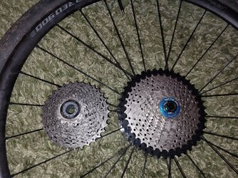

Step one: swap out the cassette. That's as far as I've gotten. I'll probably swap out the rear derailleur tomorrow and attempt the gear cable on Sunday. I'm a bit worried about that part...
The gear cable should not be too difficult if you are only replacing the inner. If you have to change both, leave the inner in place until you have replaced the outer if you can.
