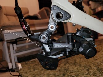

Deore rear mech installed and new inner ran. It actually was pretty easy. I left the outers on, but will most likely install a shorter one at the mech end. Jtek installed, but until I shorten the outer, it's not seated properly. So tomorrow's job is the outer and indexing.

You're quite right. I don't know why the 'triples are a pain in the ar$e' comment was made, given the OP has chosen the double chainring option. Can one have a triple 'mullet'?
As long as the cable pull between shifter and rear derailleur matches (or something like the shiftmate works for your configuration), I don't see why not
Ajax Bay
East Devon
Simple solution, then, seems to be just go for a 9sp Shimano as road and MTB cable pulls / actuation ratios are the same aiui.
But wouldn't a triple mullet be an oxymoron?
ColinJ
Puzzle game procrastinator!
Fitted an 11-36 MTB cassette to my CAADX and replaced the little ring with a 34. My bottom gear is now a much more ultra-steep-Calderdale-climbs-friendly 34/36 rather than the old 36/30 - about 27% lower. That required fitting a MTB rear mech (I used a 9-speed medium cage XT mech which is moved just the right distance per click by 10 speed Shimano STI shifters) and a new chain.
I don't know about 9-speed road shifters, but my 10-speed Tiagra shifters work almost perfectly with that 9-speed derailleur. (I occasionally nudge the shift lever slightly more than the click to speed up a sluggish change.)
GuyBoden
Warrington
Shimano MTB 10 speed and 10 speed Road rear Derailleur have differing pull ratios.
The newer 10 speed Shimano Shadow MTB derailleurs won't work with 10 speed Shimano Speed Road shifters.
Obviously, your 9 speed mtb XT RD-M772 was fine.
Edit: I presume that's why they're using a Shiftmate to match the differing pull ratios in their setup in this thread.:okay:
