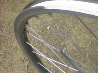

My front Mavic Open Pro rim ....
Scoosh
Velocouchiste
Moderator
Edinburgh
... looks like this now

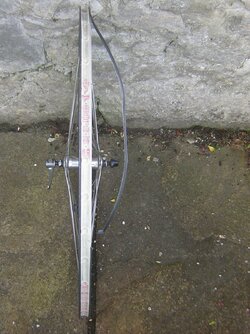

On Friday I set out on a 90km ride from Edinburgh to Aberfoyle for the week-end, with my wife driving up to meet me and early on, going up a slight hill, the front tyre exploded
I hadn't hit a pothole, bump or anything else - it just went BANG ! xx(
Didn't take me long to work out that this was not an ordinary flat tyre, so stopped quickly and saw a bit of the rim flopping about and getting into the spokes.
Ride Over.
Fortunately my good lady was still at home, I was only 8km into the ride, so she graciously came and picked me up.
I am relieved it went when it did - 30-50 secs earlier and I would have been doing 35kph coming downhill

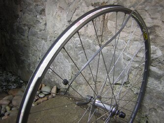

The rim is just over 2 years old, has done maybe 8,000km. It doesn't look as if the rim is worn through, so what could cause this to happen ?
That looks to be down to wear of the braking surface - although it may be due to an over-inflated tyre or an inherent defect.
Get a ruler and lay it edge on across the remaining good braking surface. There will be a gap - if you can get the edge of 3 or more pages of glossy paper in between then the braking surface is worn and that is the cause.
If the wear is less than that then I'd see if Mavic will replace the rim.
BTW - this usually happens to the front wheel as this is used in braking more than the rear. You should check the rear for wear though.

Looks like a classic case of a worn rim to me being used at a high PSI. 8000 - 10000 km use in all weathers up n down hills is about right for a lightweight race Open Pro in my opinion.
I keep a very close eye on my Open Pros. They are not the hardest wearing rims though they are tough, lightweight and make a excellant wheel.
I went through a pair of Open Pro rims in just over 12month a few year back, though I was commmuting in them 5 days a week in all weathers 40km a day, then doing 200km most weekends in the hills in all weathers.
Edit. Dont forget Open Pros are lightweight race rims. Not hardie touring rims.

Thanks for the replies, guys.
accountantpete - I'll have a measure up tomorrow and see if it is just 'fair wear and tear' - and checking the rear is very good advice too. VMT
YM - I do a bit of audax riding and the Open Pros were always highly recommended by the audax brigade - 'light, fast and bombproof' was the general response. Lightweight race rims ?? Ooops
Usually 100psi.
If not OPs - what rims are recommended ?
Usually 100psi.
Id stick with Open Pro. Why change from something excellant to something else ?
100 psi is safe. Those rims take up to 160 psi I think. Though a worn rim won't

I think mine definitely have some wear on them. I wouldn't say that I'm a (complete) wimp, but descending without braking on some of the hills round here isn't an option! It's a question of just how much wear. Perhaps I'll get some vernier callipers on them and measure how much metal is left there.
