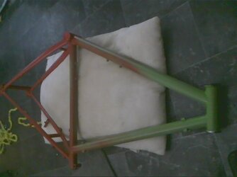

first off i needed a frame to work on the bike, so i made this up
http://i773.photobuc...id/S1052441.jpg, not bad considering its some old decking, fence posts and some screws that it was made out off
. Next i had to strip the old paint off using some paint stripier. word of warning with this, DO NOT get it on any part of you body or inside you as it will be very painful indeed!!!!.Next and the most important thing, was to give the frame a good clean( a very, very good clean!) and "key" the surface as this will give the paint something to stick to. Before painting commences give the frame a good going over with some decreasing fluid again just to make sure its clean ( i can not stress enough how important it is to make sure the frame is clean be for the paint goes on), Once the frame is clean you can start with the painting. first i used a primer (depending on what color you do, will depend on what color primer you use), i done two coats of that allowing drying time between. Next i done the base paint green, that was 3 coats, again drying time between. Next i done 3 coats of the red, again, drying time between. Lastly i done a top coat with two layers, again, drying time between. You are better off in a shed or something if you wish for a perfect paint job (because of all the rubbish being blowing about outside) but even with basic tools etc you can make a paint job to be proud of. this was the first time i have every sprayed a bike frame, so i don't think its not bad for my first attempt!
. its not the strongest of paint jobs but a few bits and bob on the frame should give it some resistance against scratches...... or would you could do it take it to a powder coaters and they will paint strip, clean and then repaint it for you, but where is the fun in that
