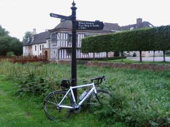

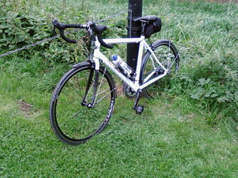

Had a run out to Middleton Hall this afternoon on my new kilmeston, 44 miles, and it was blowing a hoolie with intermittent heavy showers. I was very impressed with the Verenti, it rolled along nicely, climbed well, the double tap gear change didn't take long to get used to and changed quick and accurate, except a couple of times when I forgot and tried to change like I was still on the seven year old sora I'd been using. :blush: Wasn't impressed with the brakes but they got better as the ride went on so it looks like they just need to bed in. I need to change a couple of thing to get the set up just right, I was surprised at how high the front is, I'll have to lower the handlebars a couple of spacers, I also need a touch of height on the saddle. My question is what's the thinking behind this fifty/thirty four on the front? Its too large a gap, after having it on the turbo while I set it up I changed it for a thirty eight, but even that felt too low. The other question is why can't you get a forty two ring for these? I recon a fifty/forty two with the twelve/twenty seven cassette on this would suit me very nicely. Any way I had a good ride this afternoon, I'm a happy bunny and very impressed with my new purchase.

They call it sportive geometry, its a compact type frame but the angle on the top tube is steeper than either of the two compact frames that I have had in the past. Its a 53 frame and I normally ride 54 but now I have it I suspect I could have gone down a little more, but the next size down is a 50 and that would have been too small. The saddle is Verenti's own make, it seems OK, but my arse hasn't made friends with it yet. The trouble with the 50/34 is if I ride with the club as soon as I hit the 34 to climb a hill I'm straight out the back. Being a mature rider I now find 50 is about as high as I go.

Its the height at the front that causes all the confusion, the angle on the top tube is very steep, I have now dropped the stem down so theres just one 10mm spacer underneath it, and raised the saddle a touch and its now about set up right for me. I've got a medium and I'm 5ft 6in and the medium is a smidge on the large size of right for me, but the small would have been to small. I've now done three rides on it totalling about 150 miles, the last one I had the 42 tooth inner ring on it, made the gearing better for me, I'm going to drop the outer to 48 shortly. I'm very impressed with it, the double tap is very good, the bike rolls along very easily, climbs well and handles well. I've also noticed that I'm a lot fresher after a long ride. My only gripe has been the weather so far, I've done three rides so far, on all three its been blowing a hoolie and on two of them I've got wet on the way back.
