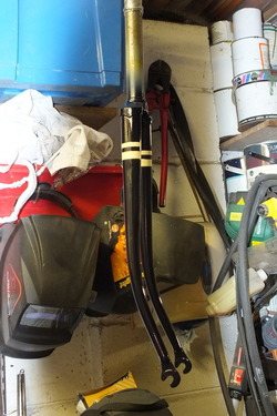

Some paint on the frame & forks.

Well, it's about done except for pedals and a test ride.
Brooks saddle & bar tape, NOS Tourney centre pull calipers and some retro levers.
Wheels and chainset are Holdsworth.
I'll put pedals on and go out for a ride and fettle this weekend weather permitting.
