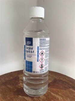

Will Surgical Spirit work on mechanicals? I use it on electronic stuff.
