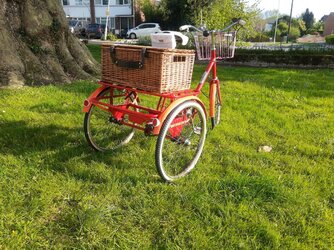

I was given a Pashley Picador over the weekend and decide to restore sympathetically, keeping the original colour on the frame and not changing too much.
Plus points.
- Both front brakes work well; hub and caliper .... the frontwheel lock mechanism (handbrake) ...doesn't, but I'm not overly concerned about that yet.
- The chrome is pitted, I don't think there is much I can do about that, but clean with T Cut (or similar) and then use a matt lacquer to protect it. I won't rechrome.
- The coating on the front basket is cracked all over, as is the very large rack on the back. (I'll simply strip and repaint)
- The rear wheels were barely spinning when I first tried riding it
- All the tyres are cracked, but I could pump them up....but will need replacing
- The Sturmey Archer gears don't work so well, the selector indexes, but it barely changes gear. I'm thinking this perhaps needs adjustment (unsure)
- The chain and Sturmey Archer Hub are more or less rust free
- The mud guards are quite badly rusted. I've removed them and will strip down to the bare metal and repaint
- I have the original ad for the bike plus the little white saddle bag (as new - never fitted) plus multitool and x1 allen key.
ISSUES
1. The freewheel axil bearing barely would barely spin, I drowned it in WD40... The free wheel runs easily now, but how do I remove the wheel ?
I thought after removing the large cap/nut it would simply be a question of pulling it off, but it's not.... I'm loath to give it a whack with a hammer and damage the
wheel
2. This may sound a bit of a daft question; how free should the drive wheel run/spin ? I haven't a clue... The drive bearing and the wheel I also drowned in WD40, it runs better, but I'm unsure how freely it should run. Say I turn the peddles to turn the drive wheel, when I stop peddling should the wheel keep turning easily or stop after 3 or 4 revolutions. The only comparison I have is my road bike, the rear wheel spins for an age after I stop turning the peddles ....but on this type of bike I'm unsure, I'm guessing it should spin for a good while, but I simply don't know. Perhaps the driveshaft bearing is rusted or the bearing in the wheel ? Again, I couldn't get the wheel off the driveshaft....
3. Any tip/tricks/do's and don't......Thoughts suggestions on how best to tackle the issues I have with the rear wheels would be much appreciated.....

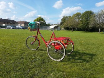

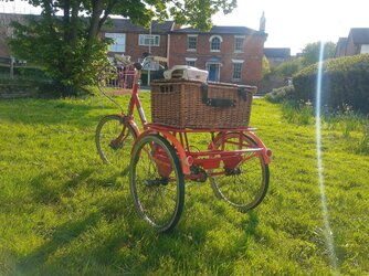

A little bit of an update.
I've more, or less, gone as far as I wanted to with the rework, there are odd bits outstanding, but nothing that I am too concerned about.
Completed
1. All paint work, essentially the mudguards, and the area around the rear rack where the paint was flaking off, got stripped down to the bare metal, primer x3 coats, top coat x3 then lacquered (gloss)
2. The chrome around the front, essentially the handle bars, was lightly rubbed back using the foil, (as suggested) then I applied x2 coats of lacquer
3. The SA gears I adjusted and now work well. It seems pretty good to spin in first gear.
4. The brakes work well, no adjustments necessary
5. The frontwheel parking tab, which locks the hub, works well, though a little fiddly to get the hang of.
6. All bearings greased.
Outstanding
1. Clean the chrome on the wheels, then prime and paint with "chrome paint" I tried it out earlier in a few small areas and it works well.... it's not perfect, but looks ok ....
2. Contact the names, as suggested, to find out how to remove the rear wheels, I've stopped fretting over that, but really need to investigate this.
3. Hunt down one of the funny washers with a tab, for one of the rear wheels. I believe one of the earlier posters said he might be able to help me out...so in advance a big thanks.
Anomolies
1. The funniest one; the drive shaft (axil) wasn't transferring drive to one of the rear wheels, it now does, but I'm unsure why, perhaps the big nut that holds the wheel to the axil, wasn't tight enough, but I could be totally wrong. Magically, it seems to run fine now.
2. I decided not to straighten and fiddle with the mudguards, they would need a good bit of bending and I didn't want to loosen the fixing rivets on the mudguard, they're not rubbing the tyres, so decided to leave them as is, also, Suzi liked the twisted skewy look.
Riding
I think is very much; ride and keep riding the bike to get to an understand the handling, changing gear and so on, it then doesn't feel so odd. As I said I'm a road cyclist, but Suzi isn't, she has no confidence on a bike with x2 wheels, but is really happy on x3 wheels, she's still a bit twitchy on the roads. I'd add a larger % of drivers seem to give her more time and space.... than those on a road bike, ie me.
Hope you all enjoy the pictures and thank you again for everyones input and support.
Best wishes.... Phil
