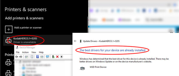

I seem to remember a similar problem with a similar printer. Basically, it's now too old for the driver installed to work properly, and there are no later ones. Despite my words about the Canon above, I'll probably be in the same boat before long.
All good plans, hope it works!aye, no new drivers on the Kodak site so I'll try the following:
Look into disabling that WSD Print Device which (AIUT) is its own printer driver
Completely delete the drivers and reinstall them in case the installed driver is somehow corrupted.
See if there's any third party drivers I could use.
I might have more luck from my laptop, but that's also W10, or failing that, transfer whatever i want to print to an SD card and print from that.
