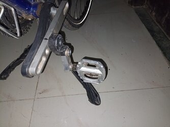

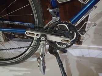

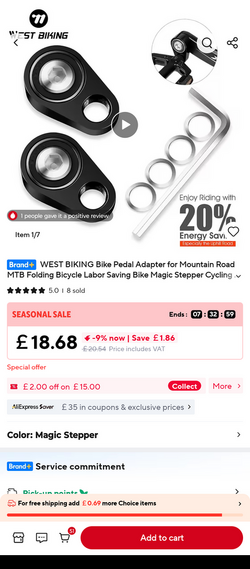

I have the regular pendulum cranks on my bike in Newport, S Wales. For my annual winter cycling in India I have for years kept a touring bike in a self storage unit in New Delhi. For this bicycle, being on a tight budget, I have installed semi DIY pendulum cranks using SJS crank shorteners (obtained a s/h pair for £25; £60 new), mini-pendulum cranks (around £20 from Ebay or AliExpress) extended to 85mm using shortened knackered left and right cranks with 15mm drilled holes to accept 9/16" 20 tpi bolts (from another set of the above mini pendulum cranks, another £20 (seems impossible to source both handed 9/16" 20 tpi bolts). Total cost for this adaptation was £65. I have test ridden for 6 weeks now with no undue issues to my grade 3/4 osteoarthritic knees. Despite the extended QR factor.

One minor downside to this. The left crank shortener is fixed to the bottom bracket axle using a boss with normal right handed threads. I detected slight loosening of this boss due to left handed rotation of the left crank assembly. Just need to tighten at intervals
