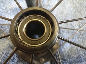

Thanks for the above advice Having enlisted the help of my brother i law (a former tool fitter and maintenance fitter he got the wheel bearings out in a jiffy plus making up a bearing extractor and press for the freehub We found that the drive side rear wheel bearing far more worn than the the other side, both the front wheel bearings are slightly worn so It surely good practice to replace all. Plus one of the free hub bearings is worn too so until I get some decent replacement the carbon bike is of the road, though am assured that it is the work of half an hour to fit the new bearings, Can you recommend a good brand of bearing SKF or Timken perhaps? Oh that won't cost the earth

Thanks Graeme, I must say I don't know anybody around here that supplies bearings but I can enquire at my local suppler of all things taps dies and nuts and bolts would think that they will know someone. if not themselves as never enquired about this area of their market Thanks for all the sound knowledge . I might mention that the ones fitted are S&S as the picture of rear wheel bearing shows.
