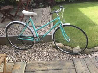

I scrub rusty chrome plating with tin foil and cola. Will solve the problem unless the rust has eaten through completely, and even then the result looks better than the rust.
This one had rusted wheel rims and handlebars:
Looks great. How do you protect it afterwards to encourage it not to / stop it coming back ?
sevenfourate
Devotee of OCD
Alu foil with acid like vinegar/lemon juice then Autosol metal polish which leaves a waxy protective coating.
