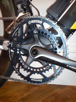

I have a set of Q-Rings however I run them with carbon cranks, I find the shifting to be OK in general but can't say I'm convinced regarding the claims, a more extreme elliptical shape such as that used by osymetric may be more noticable .
I do find however that they seriously mess up the data from power meters yet rotor have just released their own, I would be interested to know how they have addressed this.
Here is a image of my q-ring setp

BTW, looking back at your images, I think you MAY have the big ring 180 degree's out of alignment. That silver metal tab/pin should (as is usual) be located behind the crank arm, it serves the purpose of stopping the chain getting jammed between spider and crank arm if you toss the chain outwards. Maybe there are 2 of these on a Rotor due to the adjustability, I do not know, just thought I would mention it in case :smile:

Indeed there are two and one is hidden behind the crank arm. My rings are in the default "3" position which is recommended when you start out with them, you then move them to other positions (5 in total) to fine tune to your ride style.
