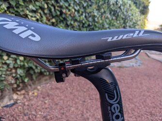

Hello,
During a ride my saddle will slide back, no matter how much I tighten it. I do not want to change seatpost as it's a nice carbon thing.
Thanks.

From what I can see on the pic (not sure), the clamp looks like having a bolt on just one side, that's a weak design due to wrong side of leverage - the bolts force should be leveraged to the clamping surface, not vice versa. Also, with just on one side, you get a friction concentration - wear, near the bolt head at an edge, that gets worser.
A clamp with a bolt on each side doesn't suffer this.
Ajax Bay
East Devon
Each of the two elements of that clamp has a bolt (front one hidden in the image, head recessed in post). It's a Deda Superleggero carbon 25mm setback post.
Deda describe the clamp as a single bolt but really it's two: one at the front to set the saddle angle and one at the back to tighten everything up. Once you have your saddle angle set, you can remove the saddle using just the one bolt, although it's actually easier if you undo both (but you then have to reset the seat angle when refitting).

I was talking about the front clamp/side alone, in the given picture. The single rail (there is a second one at the back).
On that single rail, below, there is a bolt head visible, bolt going to a black (metal) part.
Above it, faced away, a red (plastic?) pad, with some pin going through the black metal part.
This way, the clamp on that single rail, exercises a leveraged force on the bolt head, or in other words, the bolt needs to be tensioned more to result in a same clamping force.
With two bolts, on this single rail clamp side, it would clamp stronger and thus slip harder / stay more in place.
Alternative, a hole drilled through the center of what is clamped on, but this is no option here, due to the small section of the rail.

I don't know if it's the shadows, but the part of the rear clamp (the one with the bolt showing) that sits above the saddle rails appears to be sitting higher and possibly therefore grippping less than the front clamp. If you look closely the front one, the top looks to slightly cover the top of the number 6 and the division marker before the number 7, while the rear one seems to be sitting above the number 2 and clearing the division marker.
Is it all seated(!) and tightened correctly - as above with the clamp and seat rails being metal, you should be at about 8n/ms

Well I tried most of the recommendations except the kettle one, and still it slipped back. I think the actual clamp is just weak as the recessed front screw constantly loosens. In light of that I was wondering if you can just buy a clamp. If not I'll have to get another carbon post.

Now that you've zeroed in on the cause, might be worth considering a serrated washer: something like this:
https://www.tcfixings.co.uk/product/m6-a4-internal-serrated-shakeproof-washer-din-6798-j/9926?
I don't know the bolt size but this is for a 6mm screw. Obviously its outside diameter would need to be small enough to fit into the seatpost 'slot' and not risk damaging the carbon.
