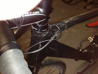

V do you have a standard way of configuring the handlebar cable setup I'm finding the rear brake cable is getting caught on the control box but cant seem to work out a better way of organising the cables and control box.

I do have standard way of doing this Ziggy, are you running dura or ultegra? And what bike it is... can you confirm when sitting on the bike what side your rear brake is?

I have Ultegra on a Canyon Aeroad and the rear brake is on the left, entry into the frame for the rear brake and control cables are also on the left shown on attached photo

I connect the junction box to the front brake cable and connect the loom clip to the other side of the front brake cable
You can see the junction box attached on my Tarmac, with the loom clip not attached yet

The method shown above is the one suggested by Shimano, any other option such as attaching to the stem or rear brake cable makes the control panel to hard to view for testing imho

If you would like me to make suggestions on your routing Ziggy, take a pic of the front of your bike around the Di2 area and stem and I would be happy to give you my thoughts

All sorted now from looking at your picture I realised what had gone wrong and managed to sort it. Just after Christmas I had a bike fit and as part of that I had my stem lowered this inturn had made the front brake cable to bow too much and this was fowling the other cables. I just shortened the cable outer and everything now moves freely. Its amazing how some things are so simple that you miss until you see it from a different perspective (your setup).
Thanks for your help.:thumbsup:
