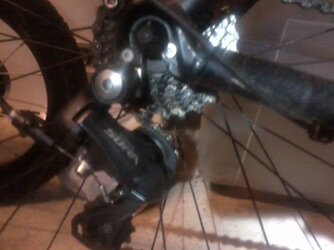

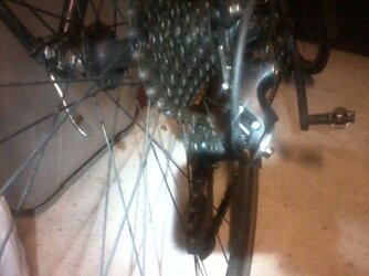

Do you have a similar setup to mine? (12-26 rear, 30-42-52 front) if so did you go for the short or medium cage?
run a 12-26 with a 50/34 compact double and i went for the short cage ,listed as a max capacity of 27 teeth but i reckon you could push it a tooth or more if needed.
Is there much left in the cage with it on the biggest cogs front and back? I have a cupboard full of stuff I've bought for various bikes then changed my mind (Topeak wedge bag in large, medium, small and micro for example - settled on the small eventually) it would be nice to get it right first time just once :sad:
cyberknight
plenty of adjustment on the b screw , should be close to the largest cog anyway.
if you want a piccie i can oblige.
cyberknight
Here you go, chain+ cassette are less than a month old but in need of a clean :smile:,lots of room left on the b screw.
