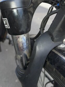

  1. the suspension is rusted

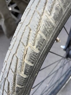

  3. front tire
How bad are these problems, and Can it be fixed? Or are they disqualifying?

A bit of fine emery will clean up the suspension.

Corrosion on the fork looks superficial, as does that on the chain. I see it has a front tyre - these are generally considered beneficial 👍

What about the tire, are those expensive, difficult to replace?
it looks torn.

What does a tyre cost? Not that much.

Basic Suntour forks - just make sure they go up and down, there is nothing more you can do with these. If they don't move, they are dead and corroded. All you can do is clean them up and silicone spray the seals. Will need a new chain.
Tyres are getting a bit old, but should be OK for now. Wouldn't be paying $250 for that though, maybe half that. I picked up a very nice Colnago Cyclo Cross bike for £330 last year, which has a much higher specification. Used bike sales aren't at a premium price anymore.
