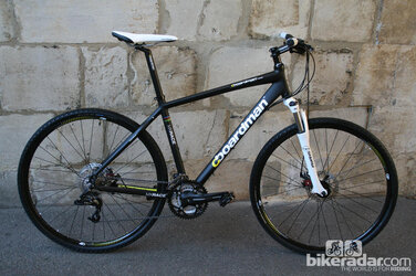

2013 boardman mx race left outside by the back gate along with a kids cheap bike and a load of other scrap so i grabbed it asap.
Chain rusted solid so i replaced it with an 8 speed one i had in stock but its a 9 speed bike , everything shifts ok apart from 9th to 8th so im guessing its just a bit wide to work properly and i will get a 9 speed chain and re cable it in the future .Brakes and wheel bearings need some tlc and the saddle is ripped but at least the seatpost is not seized so i got the right seat height , had a quick pootle around the garden and it feels very weird with the higher BB and sit up style compared to road bikes. Not sure if its a small or medium as the stats state 565 top tube for small with 170 cranks but looks like its a 565 top tube with 175 mm cranks .
Small has a 90 mm stem and the med has a 100 so push comes to shove i could always bung a smaller stem on it .

Photo updated ....

Photo updated ....
