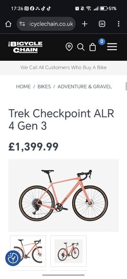

I'm 5'11
The bike I'm looking at below

I'm 5'9" and most of my bikes are large, with quite a large showing of seat post. But my Giant is a medium, however all my bikes are set so the riding positions are very similar.
As said above, try a few bikes at your LBS or even Halfords, to get an idea of what you need.
Animo
Go to Geometry Geeks and compare your existing road bike and the intended new one. You can check multiple sizes. Just remember to factor in stem lengths if different.
