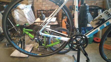

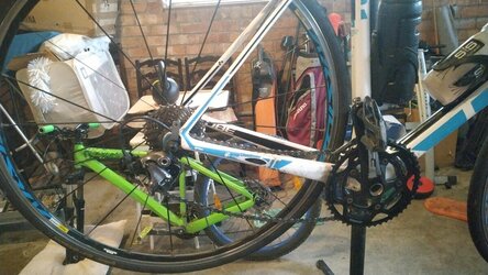

Morning ok a couple more pictures that may tell a story 1 the set up in smallest rings 2 in both big rings and a video of the freehub not working

PS I'm no expert, but that chain looks the right length for big/big but slack for little/ little which implies the derailleur doesn't have sufficient capacity. Assuming that's not the case, another possibility is that the pivot bolt isn't free to rotate- might be crudded up or corroded. WD40 and vigorous reciprocation is recommended in such a circumstance. (For the derailleur, not the blowjob, I hasten to add)
The upper part of the chain should always remain in tension regardless of whether the chain is too long or not. In the first picture you show the chain is clearly too long, but also the upper part is slack. This means that @fossyant was correct in what he said above about the freehub being sticky - you need to get this either replaced or serviced as it can cause you to have an accident as it causes the derailleur and chain to behave unpredictably. Best case scenario is you find yourself unable to pedal forwards anymore, worst case you can end up in A&E - I've had both happen to me.

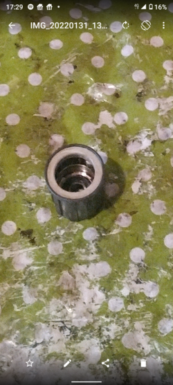

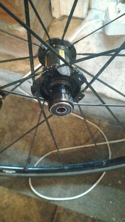

Took the free hub apart , degreased , cleaned put back together with minimal lube , sounds ok , never seen a free hub with this pawl set up , any tips

That rear derailleur looks a bit on the short side, but if it was previously working ok then the chain's too long. Worn chains are longer than new ones, so the new one needs to be the same number of links as the old one, which is not necessarily the same length.
