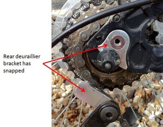

My son's Dawes Bullet has broken - the rear deraillier bracket just snapped. Must have had some rough treatment.
Trouble is, I can't find the part on the Shimano parts list. And the bracket fits a shaped recess in the frame, so I'm wondering if it is a Dawes part.
The rear set is a Shimani RD-TX31.
Any ideas welcome. I'm waiting for a reply from Dawes.
I've attached a pic - apologies for the spelling:

That's a replaceable drop-out, and it'll be a Dawes part. SJS also do them, although whether they'll have one for your frame I don't know. They've got a few hundred different ones...
actonblue
Have you got the bit that has broken off? If you have take it to a good LBS to get the exact match because there are many different types and it would be a bit frustrating to be sent the wrong one.
They are simple to replace once you get the correct one.
