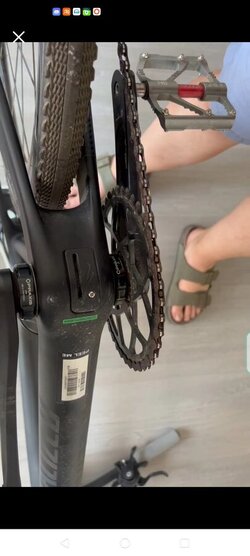

Maybe a silly question but I am new to this space. Could any one tell me what is the mounting device for (as shown in the picture, right above the green label)?
More specifically, can I use it to install a kickstand?

No, I think that cover is to feed gear cables round the bottom bracket, as it looks to have internal cable routing

Given it is carbon clamping the frame with enough force to attach a kick stand sounds like a very bad idea , carbon is great within its design parameters but crushing force is not what it was deigned for .
I thought it looked like a carbon frame, but didn’t know enough about the bikes spec to be sure, however clamping anything to a carbon frame is lesson 1 of how to destroy a bike

As above not the type of bike designed to take a kickstand, see specification. https://www.specialized.com/gb/en/sirrus-60/p/200224
Suggest finding a Specialized dealer would be highly suggested for before moving forward with the idea

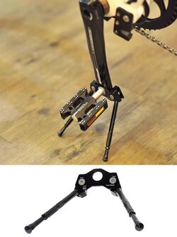

I agree that a clamp-on kickstand is a bad idea for carbon. So just another option to consider: some merchants are selling a kickstand that can be installed between the crank and the pedal, as shown below. Does anyone have experience with such a device?

Looks a much better option...

No experience of such a device, but seems a perfectly good solution for a carbon framed bike, I had no idea such a thing existed

I think the rear axle ones as suggested by @cyberknight would be more stable, the pedal one is at the mercy of the crank remaining in place and not rotating.
