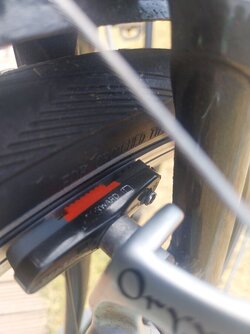

While scrubbing the rims made little or no difference to the decibels . I had a brainwave and found a pair of brake blocks in one of my old quality street tins full of bike bits.
I dont know what make they are but a short trial run seemed to show stopping power at least as good if not better than the old jagwire set and best of all silent. A longer hilly ride will confirm but at the moment I am delighted.
If anyone recognises the make it may be usefull in the future.

They look almost new, I have no idea why I didnt like them and consigned them to the spares tin last time around .And the good folk of Vale of Glamorgan villages can enjoy their Sunday morning lying in .

Just been out to ride a steep downhill. With the " new" blocks the braking is better and makes barely any noise so I am really pleased.
I am still racking my brain trying to remember why I stopped using a nearly new pair of brake blocks .
si_c
Wirral
They're generally OK pads - mixed compound types so should improve braking a bit in the wet too.
Plus as a bonus you've now got shoes which accept replacement pads too.
