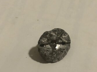

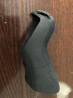

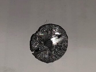

I had the same problem with R8050 (Di2 ultegra) - root cause was I hit the deck about six months ago and tore my left hood. I should have replaced it but I didn't. Sweat and water pooled around the bleed screw and by the time I tried to remove it, it was shot. My LBS suggested replacing the entire lever (and it would take three months to get one). I used a rotary tool to score the top of the screw which created a notch for a screwdriver. It opened easily with a screwdriver. Agree poor design overall, but seems ridiculous to replace the entire lever. Btw, lesson learned on the ripped hood - replaced that too.
Re-reading the original post, realise that the problem was stripping the thread that the blead screw screws into; not the stripping the hex notch of the bleed screw. In any case, somewhat related and hope my experience helps.
