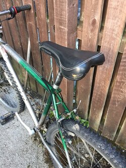

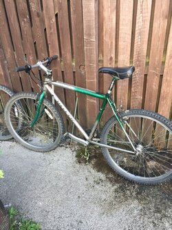

Hi everyone hope somebody can help me I’ve got a carrera mirage and the seat post is stuck any idea how to loosen it any advice would be greatly appreciated

not sure of the size i got it like that but didnt realise the post was stuck until i tried to move it as the seat was to oneside and not in the middle

That looks like a aluminium post in a steel frame. Quite common for them to fuse over time. The demise of many a good frame.
