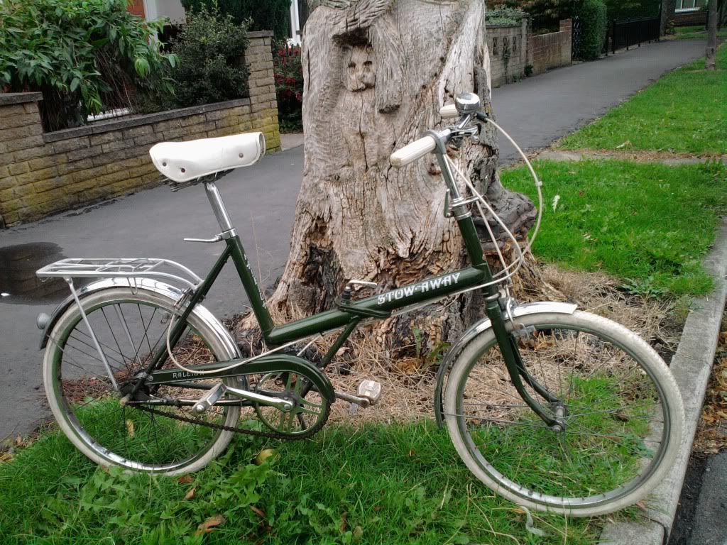

I'm not mechanically minded but I'm willing to give it a go because this bike was cheap, so please speak slowly. I doubt it will help, but here's a picture of my bike because I think it's good looking. :biggrin:

Nice looking bike - very retro!

Lovely bike by the way. Well worth sorting out this minor issue.

P.S. Yes, there's a cat carved into the tree. There are a few posh streets around here that have got loads of these tree carvings, there's a woodland animals one, a dragon one, and loads more.
