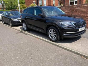

As to the upping of the OP 4x4 I would say go for it as the Skoda is 190 and I bet it's just chipped!
https://www.ebay.co.uk/itm/32535768...tixoXeJTeO&var=&widget_ver=artemis&media=COPY
Ha!!, that's a lot shinier than mine!!!
Mindst you, mine was............. the day I brought it home:laugh:
