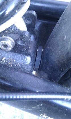

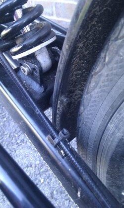

The only thing that comes loose on the Orca is the bold holding the rear mudguard to the frame. Unfortunately tightening that requires removal of the rear wheel. Grrrrr. Leave it to come loose and the mudguard will make awful rattling noises and eventually come away completely, potentially jamming in the wheel. Luckily the trip to/from work is just short enough that tightening it finger tight gets me to somewhere that I can address the issue in relative comfort!
Oh yes, it does have Loctite on the thread, but still it moves!

1675422 said:
Couple of holes through the mudguard and a ziptie should sort that one.
Only need one more hole as the bolt already goes through the mudguard - though the bolt goes into a rubber rattle reducing grommet which may be where the wiggle loose is coming from... let me see if I can get a picture...
edit: here we are
small_IMAG0534.jpg This one shows the bolt head
small_IMAG0535.jpg and this one where it ends up. Not a lot of scope for a zip tie - those convenient holes you see are for when I decide to recline the seat a bit more.
BenM
Guildford
You are probably using blue loctite at the moment, you should try red.
That is probably it - I didn't put the bike together (lesson learned there I think...) and last time I took any bolt out I think it was blue Loctite.
/me off to the bolt shop for some red stuff
