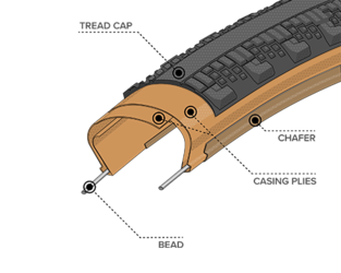

Slightly different size shouldn’t make any difference. At $60 each they’re not cheap and don’t appear to have any puncture resistance measures. I’d also look at what Schwalbe have to offer. One user posted this on their (Teravail) site:
“Since using this product for less than 3 months (600 miles) on road and compact gravel I have got over 8 punctures. Very disappointed with them as expected them to be more resilient and suitable for compact gravel.”
Their Marathon models are well thought of on here and offer a good price/performance ratio as well as puncture resistance.
