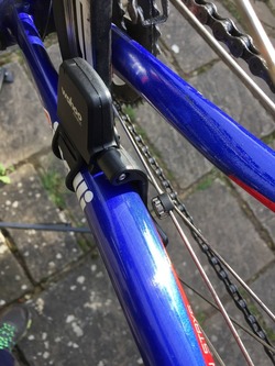

Fitted one of these to my Cinelli Experience to measure speed and cadence so I can improve my training on the commute and on the turbo (if I ever get back on it).
So in short you put a magnet on the spokes, a magnet on the crank (non-chain side), and a unit on the chain stay that reads from both.
The tricky but is getting both to be close enough to the unit.
Looks like the Wahoo pictures, but doesn't read the cadence:

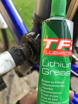

Fitting to the crank I took the opportunity to wipe and regrease the pedal:

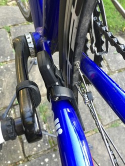

Big gap means the crank sensor isn't read:
So had to move the unit up towards the rim where the chain stay is slimmer and the spokes more distant. This allows the unit to be angled toward the crank, and the sensor arm angled down to avoid the spokes:
It doesn't look quite right, but it does work - speed and cadence measured.

Removing the BB spacer would help get the crank arm closer...

I've got one of these on the Allez and it works fine, I also angled it towards the crank to get it to work
