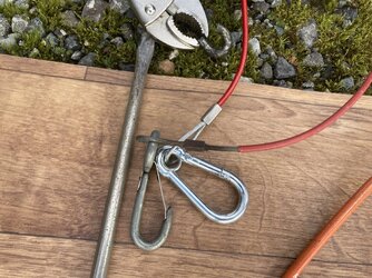

Has anyone changed an Al-Ko breakaway cable on their ‘BWSOW’?
I want to move to the carabiner style, rather than the (present) ‘dog-lead’ clip
I’m referring to the ‘closed loop’ type, not the ‘giant keyring’
This is what l want to fit (this is the official handbrake end)
How did you close the ‘eye’ onto the handbrake?
I have one of these laying about, but l don’t think the ‘keyring’ will fit through the handbrake
I was thinking about getting one of the clevis-pin style, as it might be an easier retro-fit?

I have one as a spare. IIRC there’s no need to close the loop, it just stays in place (well the one on mine now does).
There’s also a thing about how you use these different leads. IIRC the carabiner type can be used to loop around the towball (and clip back to the cable) but the clip type can’t and should be clipped to a dedicated mounting hole - or something.
I understand it to be the opposite
Carabiners are clipped into appropriate brackets/holes
‘Dog-leads’ are doubled back onto themselves, like a (dog) choke-chain
If they’re clipped onto a bracket they can (rarely, but possibly…..) settle into a position where the ‘spring’ section is in contact & would break loose in the event of a separation

I've got hold of one of the bottom style, with the clevis-pin, & split-pin

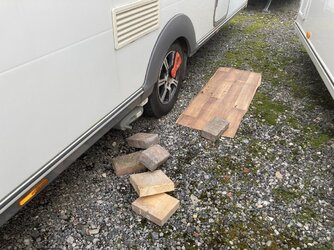

I went over this morning to put the battery back on, after its winter holiday here, on a solar panel trickle-charger
It also came off the blocks, for SWMBOs trip this coming Sunday, I'm delivering it/collecting it, as she's decided she's taking Lottie - a dumb-ass Cockerpoo
Old piece of Lino to lay on, whilst pulling them out

I also fitted another breakaway cable
I initially tried to grip the 'closed eye' with Mole-Grips, & prise it with a big screwdriver, but it was too awkward
Plan B worked :okay:
Keep it in the Mole-Grips, but cut through it with a junior hacksaw
(note the cut section in the Mole-Grips)
Then, the new cable had to have the clevis-pin removed so it could be jiggled through the cable-guide, but it all went well
I did still consider using the cable that was on the trailer that I bought, but it'll keep as a spare

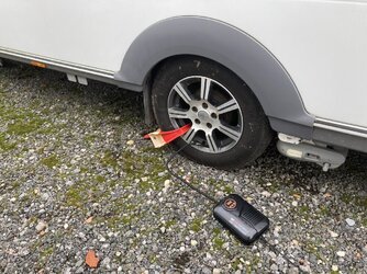

Nipped over this morning, to look for something inside it
I also checked the tyre-pressures, they were about 10PSI down (since November)
That ‘compressor’ is very slow indeed!!
Thankfully, l got an extension cable a while ago, or l couldn’t have done it without moving the ‘van
