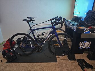

Welp, that was a short lived "win" if I've ever seen one. Picked up my new Gen4 frame 63 days ago. Heard a loud clunk noise, followed by the seat post going loose on me. Hopped off the bike and popped off the Iso Speed cover to be greated by a sheared IsoSpeed bolt or whatever this part is. Beyond dissapointed to say the least. I'm just glad I was at home on the trainer and not out on the road when this thing grenaded. I could have been seriously injured or best case walking home. I'm 6'2" 245 pounds for reference. I'm a big guy but by golly, I'm within the maximum frame limit. :angry:

All good. Just means I am due for some good luck! I'm just happy to be able to keep spinning the legs and that the shop and Trek are at least taking care of it. Hopefully will be good once I get it back, but if not, life goes on. Even if my bike "tries to kille me", it's unlikely to succeed and my life in general is likely better off in general that I found cycling. I was really unhealthy and my lack of diet an excersize was likely to kill me or at least diminish my quality of life. Albeit likely a lot slower than potentially flying off the bike the next time this bolt snaps. Lol

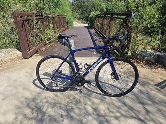

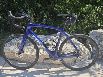

I'm going to try my luck at keeping the Domane off of the trainer and see if that helps before considering more drastic options.
So far, so good, but obviously too early to tell. The Ghost and the Trek seem to be getting along just fine though. Had to introduce them to each other slowly, but after some investigative bottom bracket sniffing, they are now best buds.
Using the Ghost during the week on Zwift, and the Trek on weekends (and sometimes around the neighborhood during the week).

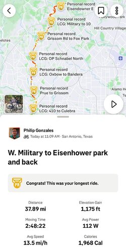

Being in south Texas, it is hot AF out though! I feel like with my fitness, I could hammer out a 50 mile ride, but not at 100F+ out! Today's almost 38 mile ride is my longest outdoors yet, even though I've done 50 before on Zwift. I'm also not as fast as on Zwift, but I'm also riding a $10,000 bike in game haha (I know that's not the only reason, but I'm sure it doesn't hurt). Also riding a greenway paved trail that is mixed use and a max speed limit of 15mph (of course I speed a bit, but do make sure to be courteous to pedestrians and other riders, etc).
I'm so used to Zwift that on last weekends ride, I rode with my tire pressure around 40PSI! For my tires, weight, etc I run low 60's for PSI approximately. I figured, since I had some GP 5000's fitted on the bike, that the tire pressure would be close enough from the recent setup by the bike shop. I didn't stop to think the bike had already been sitting a week by the time I picked it up and honestly was just being lazy. Definitely made a difference today with the proper PSI lol. Still not very fast, but again partly due to where I am riding. All good, I know I'm not the strongest/fastest anyhow, but still out having fun.
