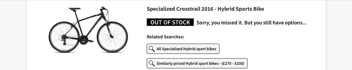

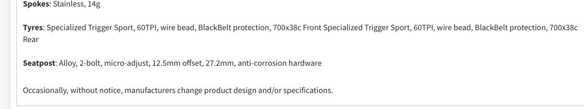

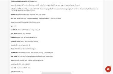

New to the forum, and hope to learn much to help me improve my rudimentary cycling knowledge. I have a 2015 Specialised Cross trail bike as per photo and wondered if I could change the tyres to a thinner variety to help the bike feel a bit more like a road bike and offer a bit more speed. Current tyres are 700 38. I am not sure how thin I could go or how wise that might be and any advice for this novice would be greatly appreciated.

I'd think you could go as thin as 28's

I looked up your stock Trigger Sport tires and they are 515g. I have mounted some Continental TerraSpeed 700x35s on my brother's Rivendell Clem Smith Jr, and they are closer to my skinny-tyred racing bike in speed than my Jamis Citizen 1 comfort bike's 700x38s. I assume the reason is that they are only 360g. They run nicely at 60-75 psi, using light butyl tubes, with Slime, because we have lots of goathead thorns here. I really like them. I will soon have some Specialized Turbo Cotton 700x28s on my old racing bike, replacing the Specialized Turbo R 700x23s that are now 35 years old, but can't report on them yet.

Your bigger issue on road speed is lugging around a heavy front suspension fork, that I assume you have because you also ride the bike offroad too?

I presume the forks are locked out. I had a Crosstrail back in 2010 or so, one of the higher specced models. Was a heavy lump of a bike and rather upright, even with slick 28/32mm tyres it wouldn't have felt like a roadbike. If a roadbike is what you want, I'd sell the Crosstrail and get a roadbike
