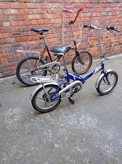

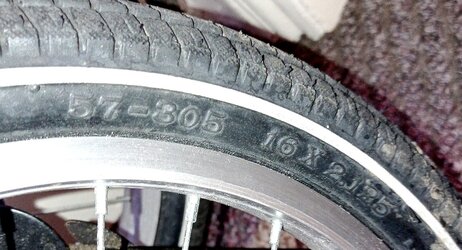

The original spec tyres have been upgraded, with new inner tubes, 57 - 305 (16 x 2.125) are now fitted. Leotyre 'freestyle'... Philippines.

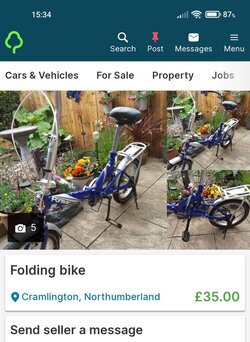

Dunno if they sold at this price..... 😡
Date label says: 2005.... If so, it's not at all rusty/crappy πŸ˜‹

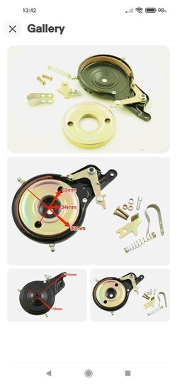

Have watched the 'repair/maintenance' YouTube on the 90mm rear drum.

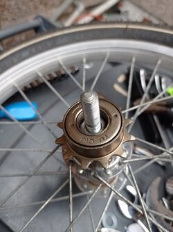

Tyneside

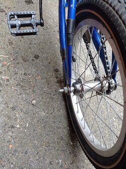

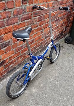

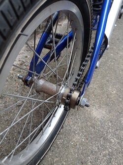

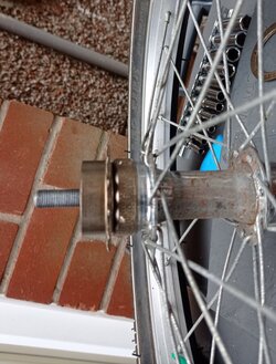

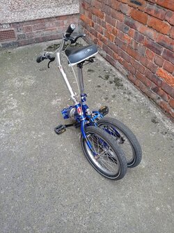

Some 'recalibration' has proven necessary....
A large nut had been fitted on the sprocket axle (inside the forks, perhaps as a Cone Locknut) but it caused the rear sprocket to be misaligned with the pedal sprocket = one or two cranks and the chain jumped off 😟
I figured the fault soon enough and stripped the whole backend out, deleted the nut [slapped a stout washer in its place] removed and refitted the BMX style 90mm drum brake assy and then reassembled the lot..... No Chain Issues πŸ‘Œ

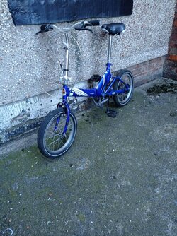

Deleted the mudguards + Noddy rear rack.
I'm going to have to do 'something', with the quill/folding hinged clamp.... It is very creaky and not confidence inspiring for a Heavy Workout 🀐.
Meantime, all the brakes are adjusted and work cleanly & sharpish!!
I think we have a winner πŸŽ‰πŸ₯‚

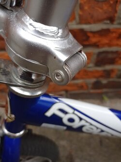

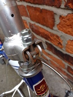

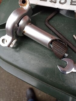

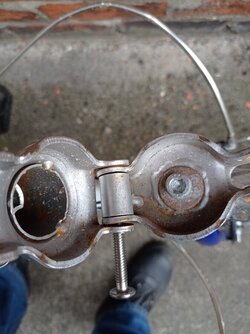

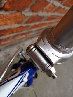

The swivel 'quill extender' is a bit rickety, after all these years. The bike has a 2005 sticker....
I have driven out the bifurcated hinge pin, replaced it with a bolt & dumped the 'over centre' latch... now fixed, with a bolt.

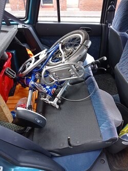

I don't need to have the handlebars 'sweep down/and over' the front wheel.... I will just chuck the bike in the hatch >> I'm not carrying it on the Tube 😡
The 1" stem of the handlebars, sliding inside the extender, is feeling a mite wobbly so a length of sink drainer pipe may be cut to make a liner/inner.
Looking much better.... Soon on the road*
*Cables + inners on order πŸ‘

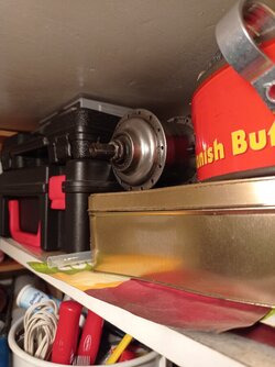

As I have built up a fresh 36spoke SA, for my Dawes Kingpin, I have a 'spare' 28h SA hub.
Just so happens this bike is 28spoke....
I see 'good things' happening here πŸ‘ŒπŸ˜Ž

My new pedals arrived today. The 'Chinese bike part' pedal is 14mm flat, the replacements are 15mm flat πŸ€”
I have modified the nylon handlebar insert/sleeve... enabling the bars to rotate 360Β° >>> from the maker, the bars are 'fixed', cannot turn off straight ahead/quill hinge drops them to beside wheel.
I made a handle/nut, to lock the quill clamp.
Comprises a length of Rawlbolt floor anchor + a handbrake balance bar adjustment nut.

Fitted and tested..... 16T off/12T on....
Transformed the riding experience, sweet spot cadence @reasonable 'rolling along' pace πŸ˜ŽπŸ‘
The 16T whizzed off, with the tips in the vid I posted, dead easy.... Whacked the drum off, too!
I had to file off the peaks of the cone locknut because it wouldn't fit in the 18mm clear bore.... Not a problem πŸ”¨
Just got to swap/fit up the calipers and it will be fit to face the road πŸš΄πŸ†
