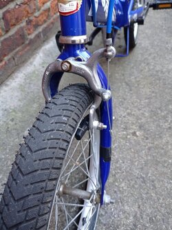

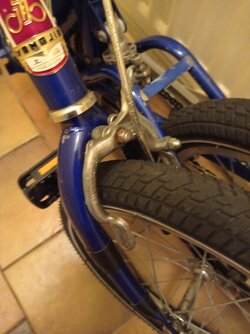

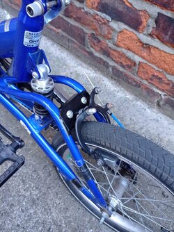

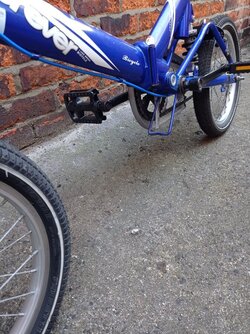

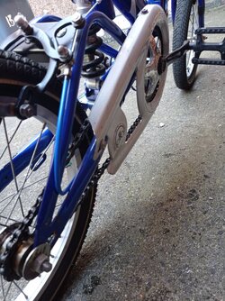

Stripped off the FRONT factory caliper (pressed steel).... Stripped the newly acquired Alloy caliper.
Swapped the pivot bolts as the alloy caliper is a 'rear', and the bolt is just too short 😟

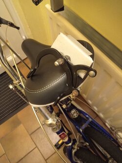

All reassembled and the brake blocks removed prior to slipping calipers over the tyres [they are quite balloony, over the rim width]... Just need to fab up my plate, to take the rear caliper (was front), and I have swapped the clamp/adjustment sleeve for "bottom entry" cabling. 👍
LardAbove 🚴
LardAbove
LardAbove
Tyneside
OldBlue has now a 'new' front brake & I'm just finishing off the 'gusset/bracket' to mount the rear brake. A few holes to be drilled, paint part in Mattblack....
Test Ride coming up 👍

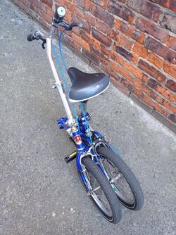

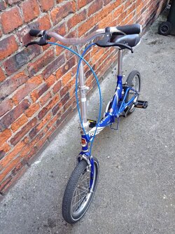

So we have reached our conclusion.... Let The Games Begin 🎉
Brakes set up & tested. Front is really sharp but the rear [the blocks are s/h and need a slice to face rim flatter] has lots to offer 👍
Some vid may be forthcoming, with the Good Lady aboard.....
