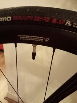

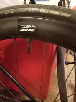

Hi there
I'm looking at buying new inner tubes. What valve size should I buy? One valve picture is for my Bianchi and one for my Giant tubeless (I'd like to have tubes for the tubeless just in case):

Looks like 60mm length.

Valve extenders are very good and worth keeping in your tool bag. Just in case you are stuck with a short valve sometime.
I have a very very deep tri-spoke and the valve extender is kept attached all the time.

measure the depth of the rim, add 15mm to that and pick the closest.
Measure the depth of the rim and choose the next valve length up. The difference between the spoke bed and top of the rim is circa (min) 20mm and that's well long enough (proud of the rim) to get a pump chuck on.
