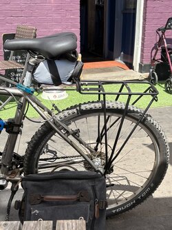

What’s a good rear rack for this bike?
Methersgate
It’s on long term loan to my elder son as his commute includes some gravel and some rough areas. He wears a back pack, but it’s not ideal. Two decent size panniers would be much better. Titanium hardtail, no eyes for attachment of anything.
Enlarged view of rear end:
Punkawallah
You can get a seat post mounted rack that will take two bags, but from memory it’s limited to either 20lb or 20kg.
freiston
Coventry
Have you got the bits to mount it at the top (either to the seat-post as per fossyant, or to the seat stays/bridge)?
fossyant
Ride It Like You Stole It!
South Manchester
I also like the fact I can fit and remove the rack in a matter of minutes. The bike is usually not fitted with the rack, but having tried to 'p' clip a rack to it for a four day bike packing trip, the 'p' clipped rack swayed more than I liked when loaded up. Searched for a different rack and found this.
