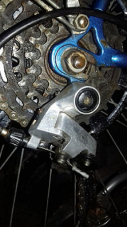

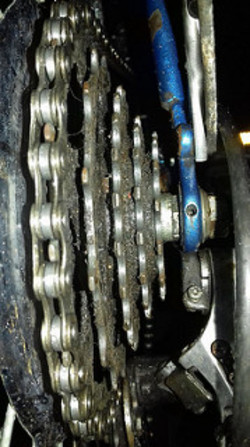

The one fitted at present is a shimano skip tooth had a proper look at it today in the light and it 34 teeth on it's lowest gear and 13 on the highest. I was thinking of going 6 speed as there seems plenty available at a cheap price but wasn't sure how much wider they are. I'm not sure of the mech but it is Shimano will post a pic. As the bike only cost me 20 quid it goes against the grain to pay much for the freewheel. I do have a triple which I could may be use with the more common freewheel sizes but it would of course destroy the classic look.The problem I have is on it's highest gear the new chain is skipping badly I'm wondering if the chain size is wrong it was advertised as 5/6/7 speed but being an old bike I wonder if this should be different. The freewheel looks in great condition but there was no original chain to compare it against.The gears are non indexed on friction shifters on the down tube. Does it matter if I use an indexed freewheel and what is the difference anyway ?I've tired adjusting the gear incase it was trying to jump to the next gear.
Thanks all.
Could do with a clean !

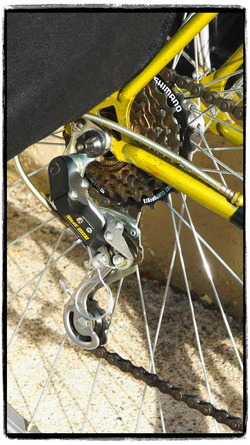

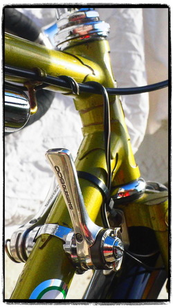

I use a 6-speed Shimano Torney on my 71 Carlton Continental along with a Duopar and 42/52 Shimano 105 up front, works well with 600 shifters set to friction. I use a narrow Shimano HG40 chain.
