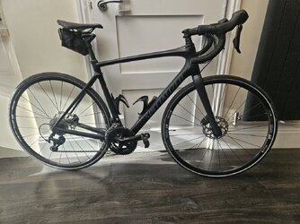

It's been a long time since posting. Ive still got my 2018 roubaix 105 which im happy with (although not tried anything else). Ive had a bike fit while back changing stem, handlebars etc but its been a long time since changing anything else. Im considering a renewal and shop recommended instead of changing bike frame, as next upgrade to change my standard wheels which will make a huge difference. Roval rapide c38 or alpimist clx II. I have max 32mm. It's a big investment and wondering thoughts and recommendations on these or others... I enjoy a good ride but no pro... just enjoying being out.

Thanks all, some good thinking here. Ive previously upgraded the seat, stem and handlebars to fit me years ago.
Have bikes changed so much that it would make a big difference To upgrade?
with all this, I know im the slow engine. Not looking to compete or anything like that. but am looking to change it up a bit.
Think the bike still looks smart, but when riding for so long, dont know what the differences really would be So asking here for views.
Would say wheels from zed be a good choice over say second hand known brands?
otherwise thinking tyres Michelin Pro 5 as an all rounder but more rolling and less thick than my current tyres...
Thanks again

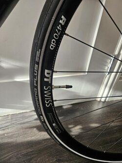

Your bike looks great as do your DT swiss wheels, lower rolling resistance tyres would help at higher speeds but that bike wheels and tyre setup is as good as many used on fast club runs, saddle looks set far back and forward slopping, could it have moved since the bike fit? if it suits you great, consider useing the bike the way it is and only upgrade tyres and wheels when due replacement.

According to your handlebar height in relation to your saddle height on your photo I assume that your riding position is more upright and "professional speed" probably is more or less twice as fast as your speed. Therefore the aerodynamic advantage of an optimised high end wheel set is very little in my opinion.

Imho there wouldn't be a huge objective benefit of a new wheel set for your bike. The DT Swiss 470db rims are good and relatively light rims - I use them in wheel sets here, too.
That seems to be a real and noticeable upgrade.
Fortunately there is a comparison functionality on BRR: https://www.bicyclerollingresistanc.../michelin-pro-5-28-vs-schwalbe-durano-dd-2020
In my experience Michelin tyres are relatively supple and riding with them is fairly comfortable.
If you want to use the tyres with inner tubes, then I suggest to try out TPU inner tubes.
Next if: If your frame and fork have enough tyre clearance, then I'd use wider tyres like 32mm with a tad less pressure. That adds comfort and reduces the rolling resistance a bit.
