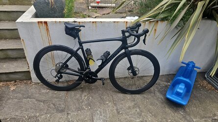

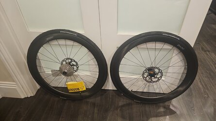

I thought id update as an interesting find. After getting the bike during covid I decided to take the plunge.
My question was would wheels actually make a difference on my 2018 bike.
I saw that carbon wheels range from low hundreds to thousands. I didn't have a need for the high end range but wondered if I should spend the money.
Previous setup: DT Swiss alloy r470 wheelset with Schwalbe Durano Plus tyres 28mm, running inner tubes.
New setup: Hunt 50 carbon wheelset (bought on sale) fitted with Continental GP5000 tyres 30mm, (could've fitted 32mm) running standard inner tubes. I like for like replaced the discs, installed a new cassette, adjusted the callipers, cleaned and used fresh chain lube and cleaned pedals, and used recommended pressure from silca.
Im a hobbyist who enjoys cycling, but by no means anything to write home about having had many injuries over the years.
wanted to share that, I did find a noticeable difference, the bike felt more responsive, rolled better and interestingly, almost 3kph faster than on the same route, effort and conditions as a ride last week.
On a separate ride, I did push it on Friday alot. For much more effort on my last set up, it was only 2.1kph slower.
(Only kept an eye on cadence and not speed as I always do). I spent below £900 in total. It's alot of money but cheaper than a new bike and more higher end equipment.
It's only one ride, but, the aim was, give the bike a new feeling, and while I did quite a lot of research and delayed for years, im pleased with the result.

Do you know the weight difference? Might be 500gms in the rims/tyres which will make a difference.

Just about all of your improvement will be due to the change of tyres.

Cool - the outright speed is probably down to a combination of the deeper, more aero rims and lower rolling resistance of the tyres (which is probably significant as GP5000s are well-regarded as high-end racing rubber, the Duranos more tough dailies).
The responsiveness will be from the lower inertia of the lighter rims.

Surprised you haven't gone tubeless, or installed latex tubes, for lower rolling resistance.
If you're capable of holding ~18mph+, the wheel and tyre upgrade ought to make a real world different, enjoy!

I think it is pretty generally accepted now that aerodynamics are the biggest factor in increased speed and the Hunt over the old DT's will be a significant improvement. Lower RR, as you say, will also play a part. As will the potential for the deeper rim being a stiffer wheel allowing for better power transfer.
One thing people overlook is that, in my experience at least, a stiffer and deeper carbon rim with the right tire and pressure seems to be a better ride feel and comfort over an old alloy rim with a narrow tire. Generally I find them just a bit more pleasant to ride.

I think the aero v. RR things depends heavily on your power output since aero drag scales with the square of the change in speed while the RR will scale linearly with speed; so the faster you are the more the aero matters.
Granted those willing to drop a grand plus on wheels are likely to be pretty serious so the aero is likely of more significance to them.
